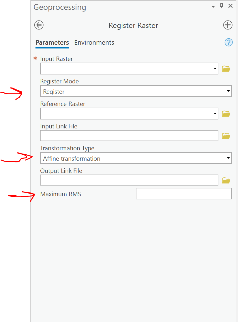

I'm trying to get a more accurate way of automating geo-referencing two images.

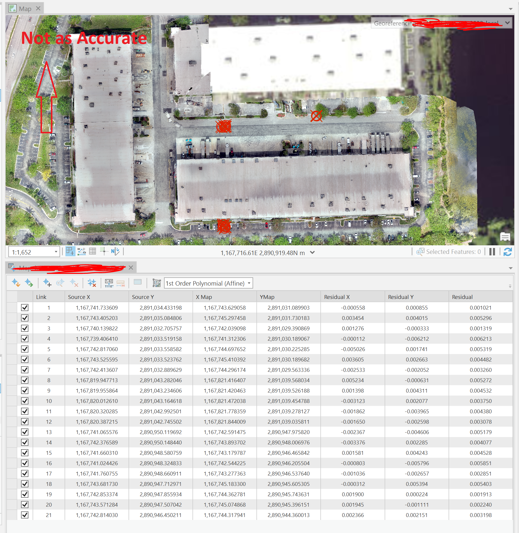

When I use the Register Raster tool, it does some what of a decent job. However, when you move further away from the control points it starts to get inaccurate. I need this fairly accurate around the whole site. It's two sites overlapping one another. Orthomosaics are 1 year apart.
Is there a way you can get more the tool to include more Control Points and maybe more areas ?
I've played with some of the settings like "register Mode" , "Transformation Type" and "Maximum RMS". Didn't really see any improvement. Any other software out there that can do this ? I need to be able to automate this process with Python.

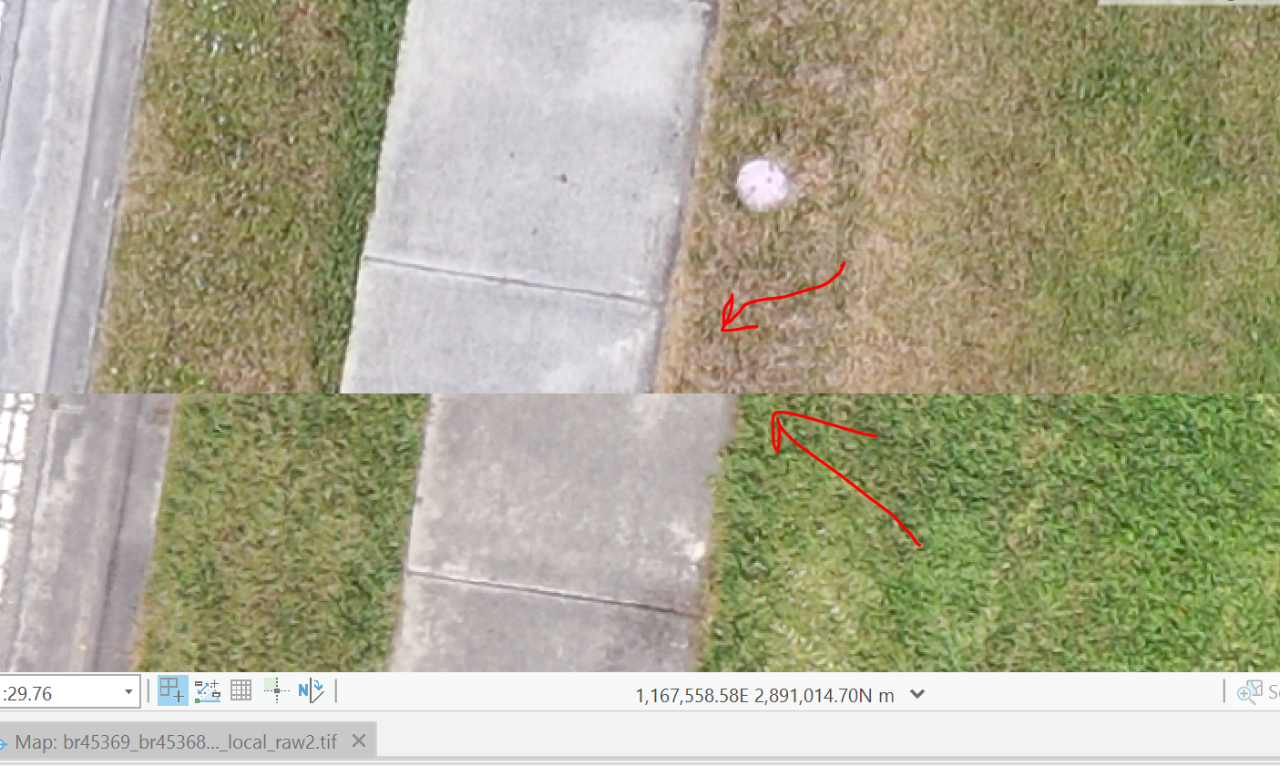

I've attached some images. the curb line is a bit off in the georeferenced image.  Capture_33.PNG

from Solved: Re: Is there any way to use the "Auto Georeference... - Esri Community
If you had your own control points (not necessarily automatic, but added from "auto")
then you could warp from file
