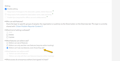

HI Bryant, I was reviewing this response but cannot figure out the solution to the issue about keeping reports hidden.  I cannot find the location to change the setting "What features can editors see" to "Editors can't see any features, even those they add".  This option is greyed out in our feature layer views.  Could you clarify or send a quick screen shot?  Thank you so much.
Dawn_Scott
Hi Chris, can you please explain how to make initial reports not visible?  I see the solution but in our solution, each of the hosted feature layer views does not have this editing option available - it is greyed out.  Thank you.
ChrisFox
@Dawn_Scott, if you open the item details of the Requests_reporter view and go to the settings page you see the following options:
If you set the highlighted setting, users won't be able to see any requests that have been submitted. Let me know if you would rather set them to default to hidden until you have the chance to triage and flag them as visible in the Manager application
