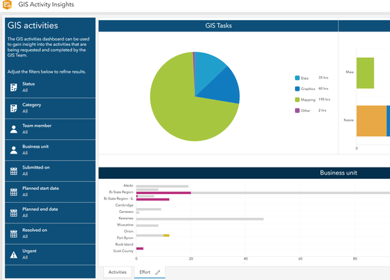

I found this thread while search for a solution to my question. I think I may need to recreate the GIS_Activities_effort view.
My issue is that I created a couple new fields for the "business unit" ( or Member Government for us), so when I went in to update the Business Unit table shown below - my new fields are not visible since the GIS_Activies_effort view does not have the update option.
So, to do this I think I need to recreate the view? A lot of this I am just learning as I go, are there any steps I can or should follow to help this be successful?
More info in case it's helpful:
The new fields are govcategory (state/region), then also govunit (specific member government based on their govcategory selection). I want the edit the graph above to look at my new govcategory field instead.

I'm not sure if this warrants a separate posting, but it's a question I have about how to follow up after adding fields, so it might be helpful to others who are here.
Where are the controls for the details/update tabs if I would like to view information for added fields in the Request Management Center, the Activities app, and the My Activities App?  The attached screenshot shows what I'm looking for within the GIS Activities Insights app on the details list widget, but for the details in the other three places, the widget is not a list, so I'm not sure where to make the changes.
The fields we added (size of the map being requested, whether the map is printed or a digital file, etc.) are essential to those working on the requests, so we need to be able to view those inputs.
Thanks!

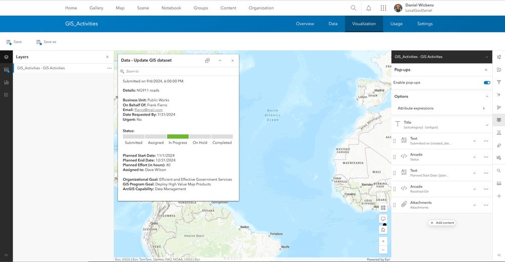

DanielWickens
@SadieBarker - You can modify the details in those apps by going to the GIS Activities feature layer > Visualization tab, and modifying/saving the default pop-up.
SadieBarker
Perfect, this is very helpful! Thanks so much for your quick reply.
