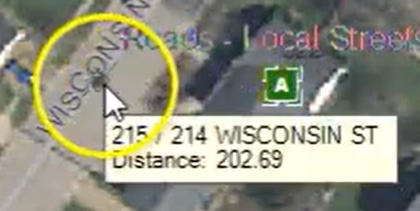

In ArcMap, using the Attribute Assistant/Address Editing tools workflow, I used to have the ability to hover over a Road Centerline and the MapTip would show the calculated address number based on where the mouse hovered over a road segment.
I'm migrating to the Address Data Management Solution using ArcGIS Pro and had a user request that functionality. However, I don't see that ability in the sample data that ships with the solution. Does anyone know if this is possible? @ChrisFox
