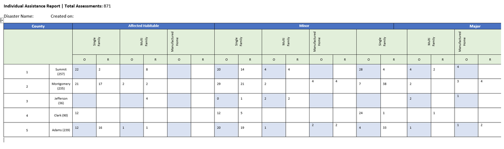

Another common request has been to further categorize these reports.  For instance, utilize a street sheet style report to summarize all properties summarized by county.  With the recent update of Survey123, report templates now allow for the where clause to be composed dynamically based upon other attributes.  Below is an example output that summarizes attributes from damage assessments based upon counties the assessment was conducted in.
You can use this word doc is an example template that utilizes the schema from the ArcGIS Solution for Damage Assessment that you can use to generate a similar report. You can extend this template by adding your logo, adding additional attributes and text as needed.
