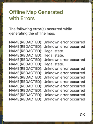

I do get some errors after AGSGenerateOfflineMapJob completes, but they are not entirely helpful.
I'm using the example on the Arc GIS iOS Runtime Docs.

and I get the following...
