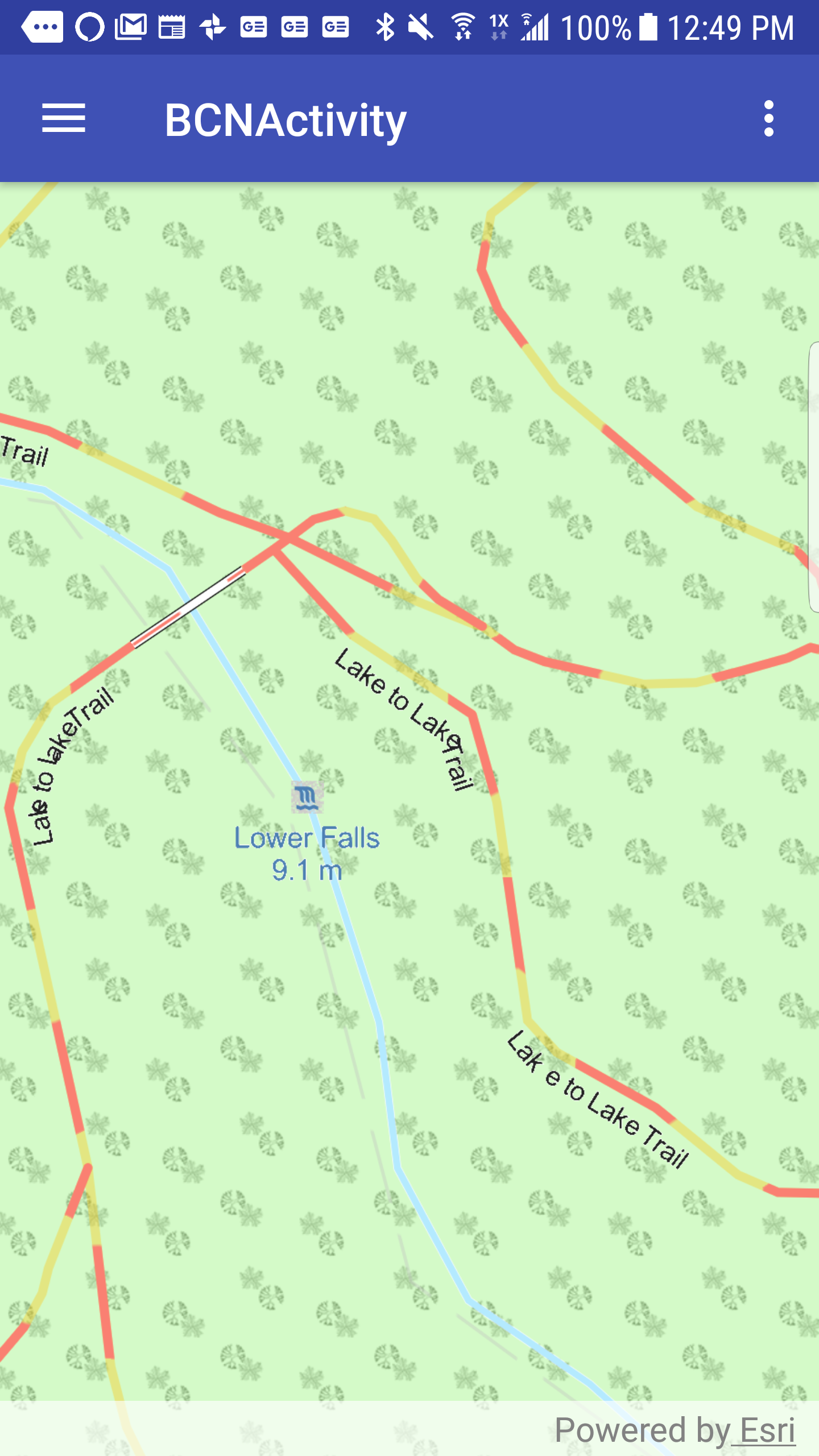

It's great that the Vector Style Editor now lets you edit symbols.
However, this doesn't work when you download them offline through the OnDemand workflow.
All the symbols are gone. Not just the ones that were customized.
Online:

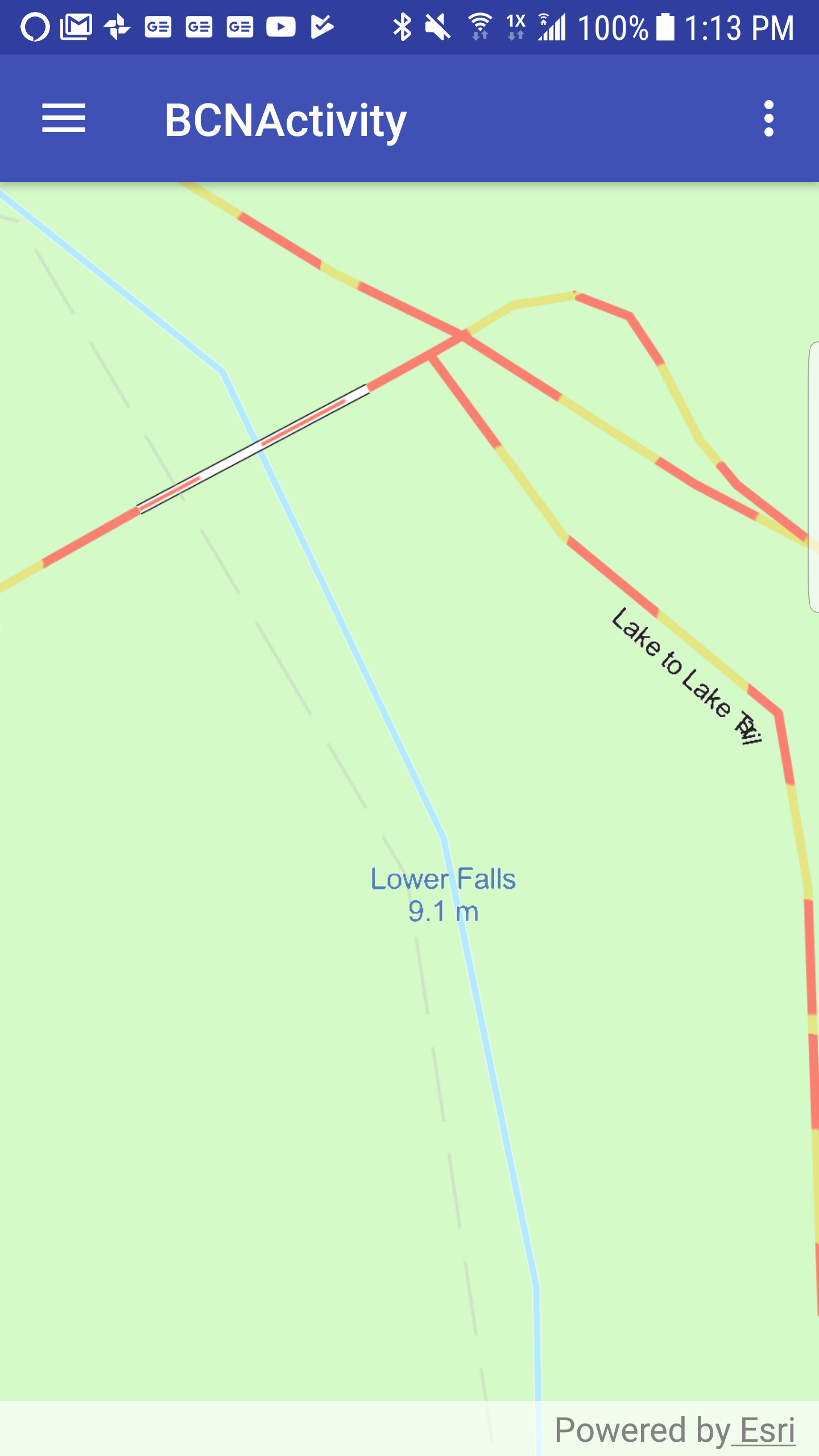

Offline:
What's missing in the second one?
The tree symbols were customized in the style. They do not appear in the offline version.
The waterfall symbol is the standard one used in the Vector OSM basemap. It's not showing up either.
