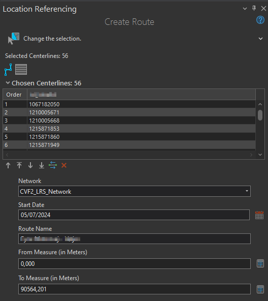

If we append the centerlines directly to the centerline feature class within the LRS container, we are able to use 'Create Route' process (Location Referencing tab -> Routes group). Here it is possible to select one or more centerlines and define a RouteName.
The result of this process is a LRS Network Feature Class with 1 new route, a Centerline Sequence tabel with 56 new rows with 56 unique centerlineIds referring to the same RouteId.

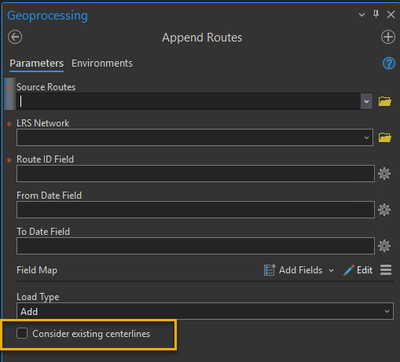

@MirekGroen The Append Routes tool has seen several enhancements including use of existing centerlines (screenshot below).
When considering existing centerlines, this tool associates routes with existing centerlines in the target LRS dataset that have an exact geometry match with the source routes. If the centerline that you append to a route does not have a CenterlineID value, one is created, and a centerline sequence record is added. If a CenterlineID value exists where you append a route, the existing centerline sequence record is updated with the appended route's RouteID value.

Thanks for your reply. Upgrading to ArcGIS Pro 3.3 solved the issue! I can see that the 'Consider existing centerlines' option became available with the latest release of ArcGIS Pro and it works pretty well. I can upload a route that is a dissolve of multiple centerlines and if the centerlines are already in the centerline feature class they will be re-used.

Append Routes tool does support loading of routes that consists of multiple centerline features. The required data conditions stated in the tool documentation.
Typical steps:
  1. Prep the centerline and route data to meet the data criteria.
  2. Load multiple centerline features using Append tool
  3. Load routes using Append Routes tool with 'Consider existing centerlines' option
