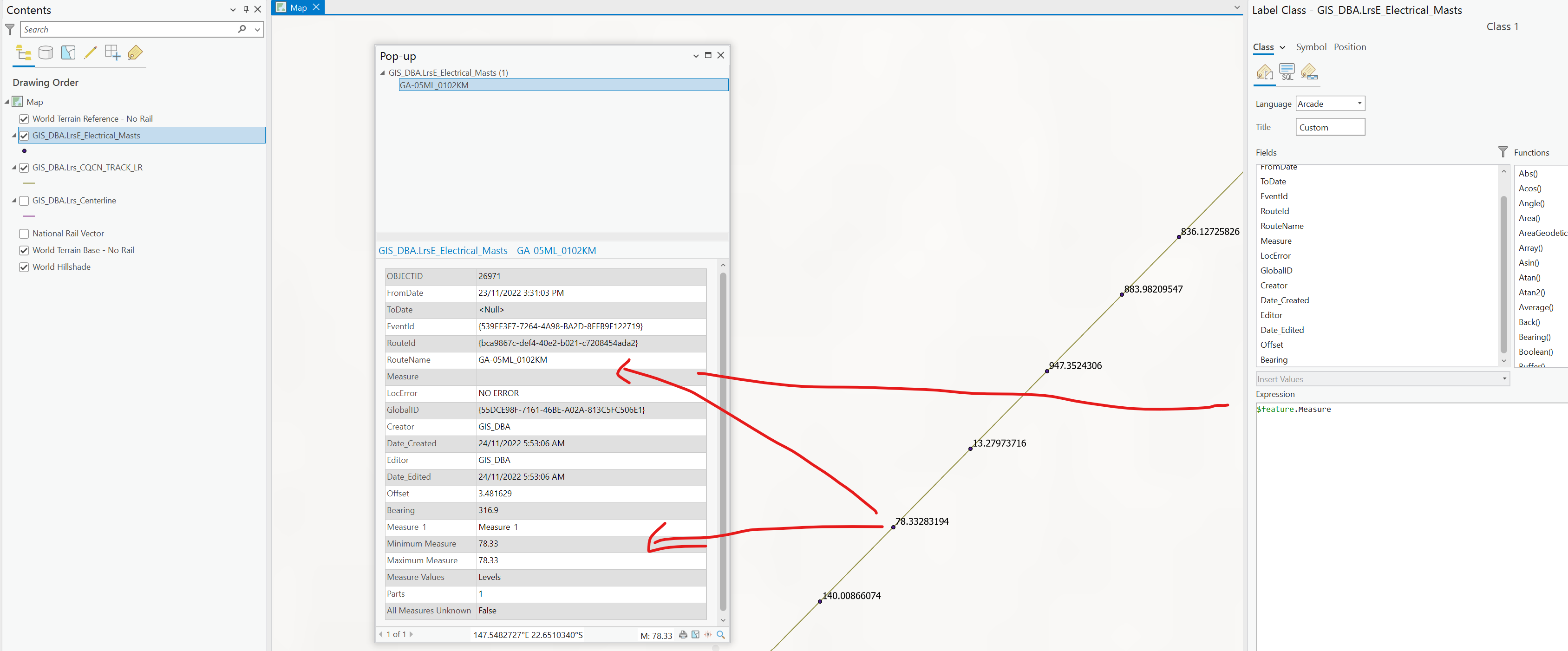

I am using ArcGIS Pro 3.0.3 with ArcGIS Enterprise 11 and SQL Server.
In the picture below I have pointed at an LRS point event to see that its Measure field is empty, while its Minimum Measure and Maximum Measure fields show a value of 78.33.  I'm also labelling the point event feature class using $feature.Measure and can see that a more accurate value is 78.33283194.
I'm comfortable that the 78.33 in Minimum Measure and Maximum Measure just represents a rounding to 2 decimals but how am I seeing the label values when I am using a labelling field with no values in it?
I'm very happy to see them labelled but why am I not seeing those same values in the Measure field of the Pop-up too?

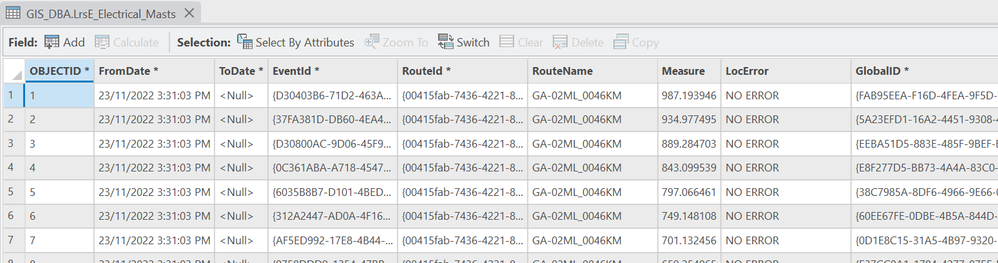

I can answer my own question by looking at the Attribute Table for the point event feature class where there are values found in the Measure field:
So that changes the question to be:
Why are the values in the Measure field not showing in the Pop-up?
