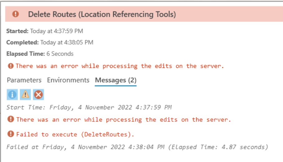

I am using ArcGIS Pro 3.0.2, ArcGIS Enterprise 11 and an LRS Line Network.
I have no Attribute Rules in this LRS Line Network.
I have no trouble using Create Route and then using Delete Routes on the same route(s).
However, I have a Line with 108 routes (and a missing route or gap in its middle) which was part of my initial data load.  When I try to delete that I get an error of:
"There was an error while processing the edits on the server"
Is there anywhere that I can look for more information on this error?
I think it must be the gap in the line because when I use the same technique to delete another Line (with no gap) from the original load that too has no problem working.

@GraemeBrowning_Aurizon You can also review the ArcGIS Server Log, filtering on the LRS service being edited. You will likely see an error matching the time window when you ran the Delete Routes tool. You can log a Esri Technical Support case to get them reviewed.
