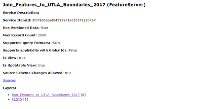

I have a feeling that this is not possible. Another approach that I am trying to work out is deleting a layer from the view and then recreating it after fields have been added to the source layers. e.g. in the following screenshot I would delete TEST5, add fields to source schema, then recreate TEST5:
Interested to hear if anyone has any other ideas!
