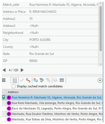

We are already using multiple attributes to obtain coordinates, but often the matching is done with a street outside the target municipality instead of one inside it. This situation happens thousands of times in our database. Consider this case, option B is appropriate while option A is not.

This looks like a quality problem for your country, can you open a support call and provide the analyst a sample of your data - thanks.
