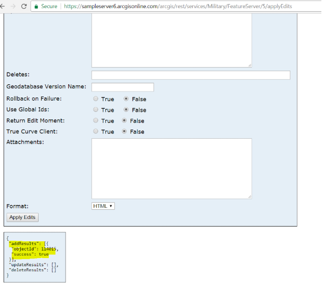

Working:

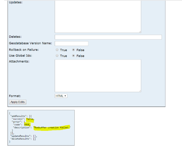

Not working:
Initially, I thought rowbuffer creation failed error is due to not mentioning some spatial reference as input, but after trying that as well it is not working.
