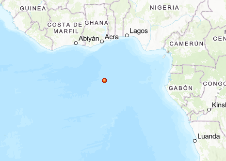

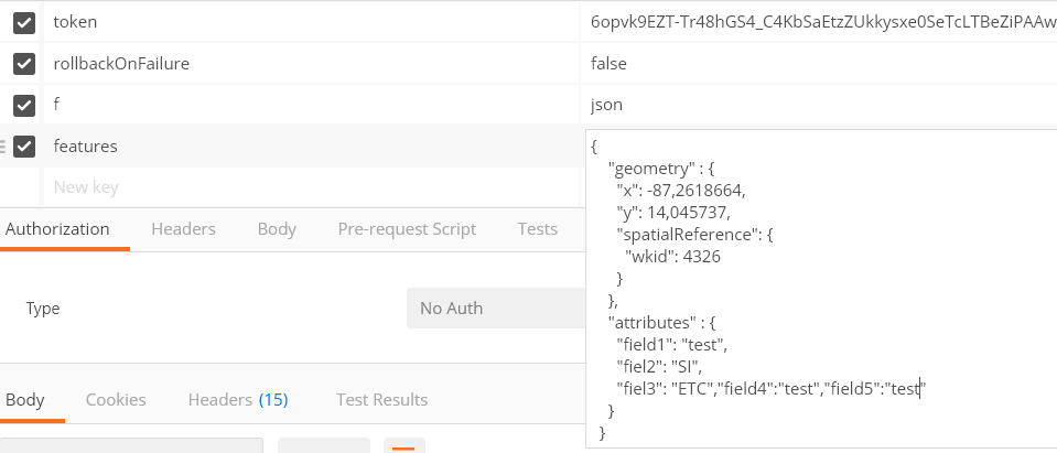

i am making a movile app and try only to add points to a feature service on arcgis online, get the xy from the celphones gps and sent it with other information through REST API and all the information was saved correct but the point always appear on 0,0

5. when i check the map the point is 0,0
6. I also try removing the spatialreference parameter and only put geometry and also went to 0,0
don't know what happend, shoul'd i have to make a coordenate convertion?

Your code is fine, including the use of the spatialreference parameter, except for the fact that you are using comma's (",") instead of dots (".") as decimal separators in your X and Y values.
As soon as you have replaced the decimal separators you are good to go! With the coordinates you have given I end up on the southwestern outskirts of Tegucigalpa, Honduras, right?

      "geometry": {
        "x": -87.2618664,
        "y": 14.045737,
        "spatialReference": {
          "wkid": 4326
      "attributes" : {
        "field1" : "test",
        "field2" : "SI",
        "field3" : "EC",
        "field4" : "test",
        "field5" : "test"

you are absolutely right, thanks for the observation. I tried Postman to record it via REST and it worked correctly
