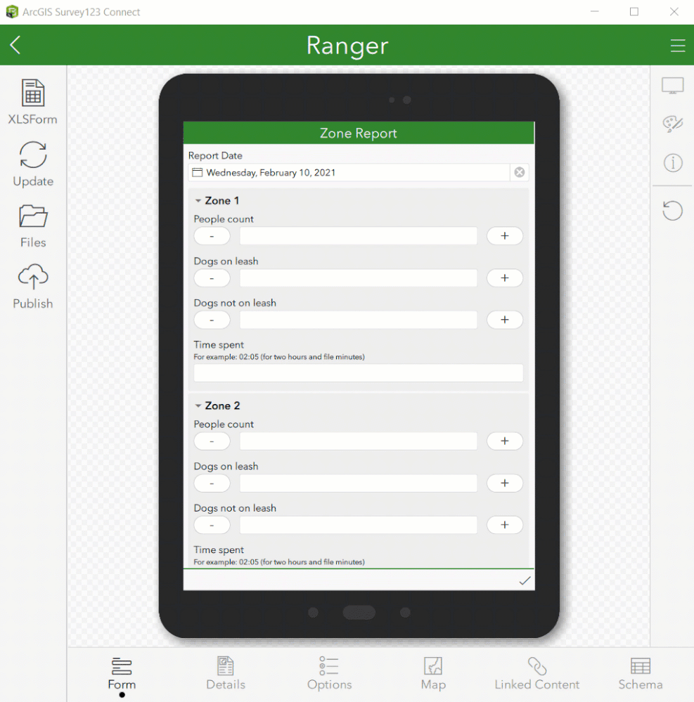

QuickCapture will create a new record when you push a button. In principle, this should not be an issue if all you want to do is to count people. Check the QuickCapture Occupancy Counter template for details.
If the above does not work for you, I would look into Survey123. Survey123 as a tally-counter type of question that seems like the perfect fit for your use case. I put together a simple proof of concept. See it below. It took less than 5 minutes to build this. It may not be perfect but I am thinking you may be able to adjust it to your needs.
This form above was created with Survey123 Connect. I am attaching the XLSForm (xlsx) so you can import it.  If you think this would work for you, do not hesitate posting further questions in the Survey123 GeoNet group.

Thank you so much for your detailed help! This is indeed a good workaround. I've worked with Survey123 before but I wasn't aware of the spinner appearance function at all. It is just what I need. Who knows - maybe I can even convince my boss to let me work with the App Builder and try to customize the layout of the form.
