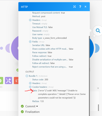

As I work to implement the steps you demonstrate in the video, I am getting stuck at the second HTTP request in Integromat, to update our feature class.  It is giving us an output error: {"error":{"code":400,"message":"Unable to complete operation.","details":["Parser error: Some parameters could not be recognized."]}}
We are not using a hosted feature layer from AGOL, we are using a feature service from our ArcGIS federated server, published through AGOL for use with our Quick Capture application.
Any thoughts on why this error might be thrown or what we might need to do differently to get the reverse geocode to work?  Also, are there any other steps needed when working with a service published through ArcGIS server?

RosemaryHatch
@SaraPluta Were you ever able to find a solution to your error? I'm getting a different error, but am also struggling in the same place with trying to write back to a service published through ArcGIS Server. Thanks!

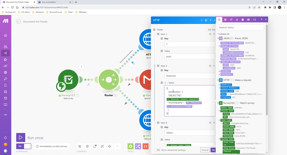

IsmaelChivite
Esri Notable Contributor
Thanks @iHack  for your time on the phone. Sharing here the cause of the problem for others to benefit from it.
In the video, I did not explain correctly what to type in the features parameter. I forgot to enclose the attributes JSON string in between square brackets. The screenshot below shows the correct JSON with the square brackets added. Sorry!
I bet this is what got @RosemaryHatch and @SaraPluta in trouble too. Just follow instructions as shown in the video... but also enclose the whole attributes JSON with square brackets!

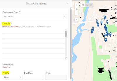

thank you for the info - I would love to use Arcade Expressions for my workflows! I started creating the Make workflow as outline in Ismael's video and ran into a token error fairly quickly (maybe because it has been disabled by my administrator? or because I didn't create the Quick Capture & Workforce projects?)
I'm new to my organization and we currently have a Quick Capture app that collects road deficiencies as field workers patrol the city. The data collected in Quick Capture appears in various Workforce Projects. One of these projects hasn't been used in 6+ months and therefore has a backlog of locations that need to be assigned to field workers (~1800 records have been created in the last 2 months). In Workforce I have the ability to assign multiple deficiencies to a field worker at one time but would also like the ability to automatically populate the location field (using the nearest civic address) and the priority (based on the road class of the nearest street).  I've added all of the feature services to an ArcGIS Pro project and figured there must be a way to auto-populate this information. I believe this could be achieved with an Attribute Rule that executes when a point is added in Quick Capture (i.e. when a deficiency is identified append the point to the workforce assignments feature class, calculate the nearest address and priority).
