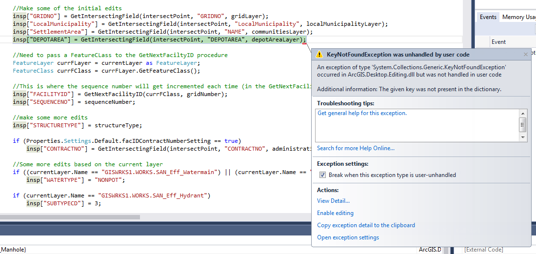

Thanks!  That definitely helps.  Now that I have gotten past that, there is another line of code that is getting an exception, but again, only when a Join is present.  Here is a screen shot....hopefully you can help with this too:
Basically, the GetIntersectingField returns a string value to populate the DEPOTAREA field.  It only crashes when a Join is present.  Again, I'm not really sure why.  By stepping through the code the proper values are getting returned.  Manually I can do the same edit to the DEPOTAREA field through the Attributes pane without any problems.
Here is the code for the GetIntersectingField, but it seems to be working fine.  The DEPOTAREA field is associated with a domain if that makes any difference, but the code works fine with no Join present.

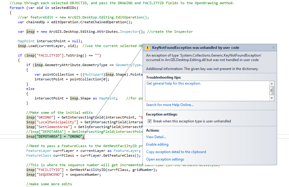

The first thing I would do is to try hard-coding an assignment to the DEPOTAREA field in code.  E.g.,
insp["DEPOTAREA"] = "value here";
Where "Value here" is a valid domain code for the depot area field.  I *think* the code is crashing on this assignment, not inside GetIntersectingField(), but this would confirm it.
Then I would check to make sure there is a field called DEPOTAREA in the result, and that the index of the field makes sense.

Hi Rich Ruh‌.  Sorry for the delay getting back to you, but I am back in the office now.
I've done some more testing, but I am still getting the same error even when hard-coding the value in as you describe above....but ONLY when I have a join on that layer.  Without a join, the same code works fine.  Is there anything else you think I should test??
