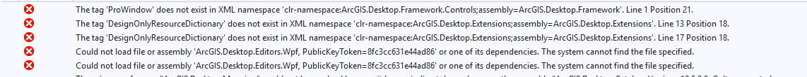

    We have developed a solution on v2.4 and which was working very good. I have updated to v2.5 and from then i am facing below errors.

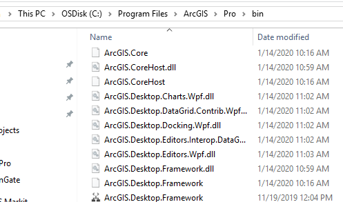

When i checked in my installation directory(C:\Program Files\ArcGIS\Pro\bin)  - i am able to find these dlls (with 01/14/2020 date.)
Is there anything else - we have to do the configurations. Please help me.

ArcGIS Pro 2.5 requires the .Net Framework 4.8.  Once you change the target framework of your project to 4.8, the errors are resolved.  Details are documented here: https://github.com/esri/arcgis-pro-sdk#requirements
