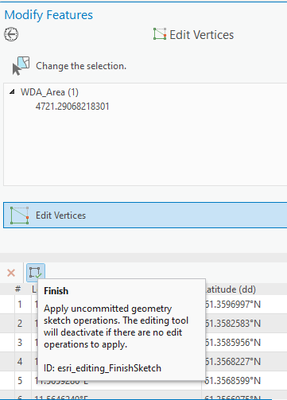

The buttons that should (and sometimes do) fire those events are the Finish/Cancel buttons on the Modify Features pane:
