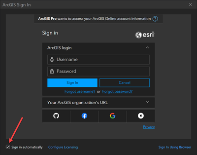

UmaHarano
If I turn on this check box, then I do not get the request to sign in every time. The code you shared opens Pro with no prompt to sign in.
WesBailes
Thanks for the suggestion, however, I also have the checkbox checked. I do believe it has something to do with the combination of the close and immediate launch.
