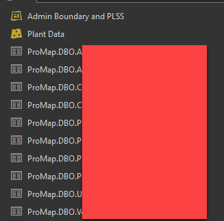

I am looking to query static table data from my portal at the start of my application.  I don't want to add the data to my map, just get the information from this table to store in memory.  I know how to add these tables to my map, but I really just want to use them as an api for information.  I almost want to simply use them as a webapi of sorts to query information from them when i need it.  I want to hide these table from our users.  I am thinking i need to somehow query against them using my portal credentials and a properly formated URL.  But can seem to get it right.  In catalog here is what my tables and layers that I want to query against look like.  Could someone point me in the right direction?
