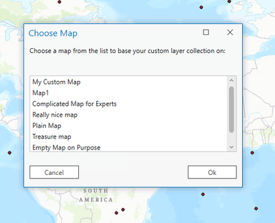

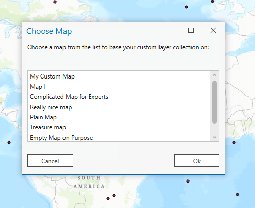

I have a pro window that is modal - it lists the maps in the project. You select a map and press ok.

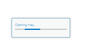

Meanwhile there is QueuedTask that opens up the map, this can take some time so I use a progress dialog just so the user knows Pro is doing things.

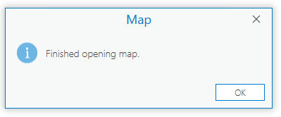

However if I don't put a message box after it has opened the map, code execution continues and won't allow the user to select a file to save the json and just says "JSON file not saved".

//!!!! Forced to put a message box here or it will run automatically to "Layer collection not saved" section below !!!!
//If you take this message box out of hte code - you will see the effect
MessageBox.Show("Finished opening map.", "Map", System.Windows.MessageBoxButton.OK, System.Windows.MessageBoxImage.Information);
