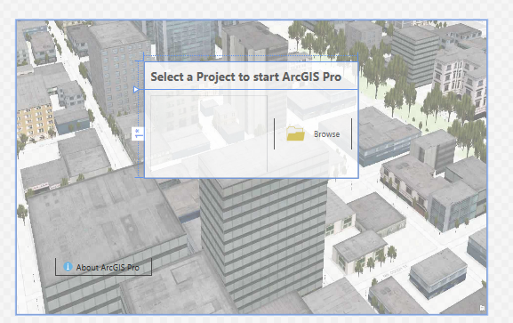

But I have one problem, with startup page. When I launch the project from debugger, I have the following sequences :
1) I have the spalsh screen which comes first
2) Then comes the startup page

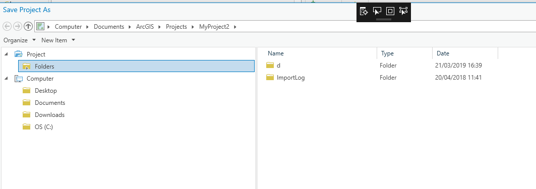

3) But startup page closes automatically and I have a screen which proposes me to save a project.
How can I configure startup page to take an input from the user and not to open up this Save Project Window.
