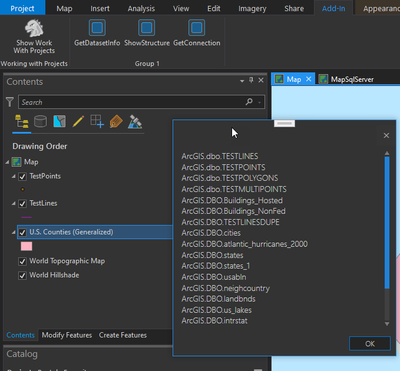

In ArcGIS Pro the .sde path is not persisted anywhere after you create a layer by adding a feature class to a map. Instead all relevant connection properties are extracted from the .SDE file, if needed the user is prompted for the password, and the individual connection properties are then kept to reconnect the layer. You can utilize a layer’s connection information in code as shown in the sample snippet below. The snippet is taken from a button's OnClick method and uses the database connection from an existing SDE layer to retrieve all feature classes from the layer’s geodatabase.
protected override async void OnClick()
    var selectedLayer = MapView.Active.GetSelectedLayers().FirstOrDefault();
    // set the sketch layer property (in order to obtain Zs, Ms as appropriate)
    if (!(selectedLayer is BasicFeatureLayer theLayer))
        MessageBox.Show("Select a feature layer on the TOC first");
        return;
    var lst = await QueuedTask.Run<List<string>>(() =>
        var lstFcs = new List<string>();
        var fc = theLayer.GetTable() as FeatureClass;
        // use the layer's Datastore to access the Geodatabase
        using (var gdb = fc.GetDatastore() as Geodatabase)
            var fcDefs = gdb.GetDefinitions<FeatureClassDefinition>();
            foreach (var tableDef in fcDefs)
                lstFcs.Add(tableDef.GetName());
        return lstFcs;
    MessageBox.Show(string.Join(Environment.NewLine, lst.ToArray()));
