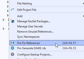

Note: i used 3.3, .NET 8 (just happens to be what i hv on my box). So u will need to change the target fwk back to .NET 6 and fix references - just use the Pro SDK tool for that.
