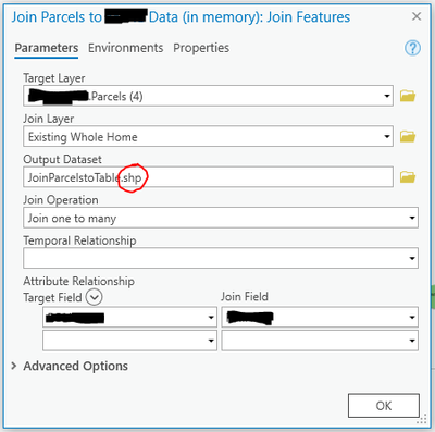

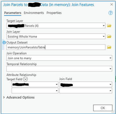

Hi there,
I'm using ArcPro 2.9.0 and am trying to use the "memory\mydata" format to join 2 layers in ModelBuilder. The documentation clearly states that I should not add a file extension. However, when I enter "memory\JoinParcelstoTable" to the Output Dataset box and click away ".shp" is automatically added to the end of my in memory folder path. When I try to run my model it fails on this tool. Any insights would be appreciated.
