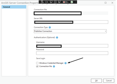

It is necessary to uncheck the option indicated in the image below when creating the connection.
