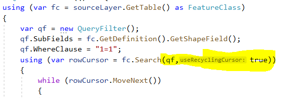

KirkKuykendall1
Maybe try using FeatureClass.Search and pass it a queryfilter that has only the shapefield as a subfield, then also set userecycling to true.
I'm not sure, but when setting recycling to true, you might need to clone the polygon geometry since you're keeping it in a list.  With arcobjects the same reference would get re-used with each iteration.  ArcObjects had a ShapeCopy() method on IFeature, but with Pro I don't see a Feature.ShapeCopy();

RehmSoftware
Hi,
I did test your approach and it was about 15 seconds faster. Setting useRecyclcingCursor to true didn't yield any benefits, so I didn't do that (but it also wasn't necessary to copy the shape when it was true).
The speed benefit obviously came from setting the subfield. Thanks a lot for your suggestions!
