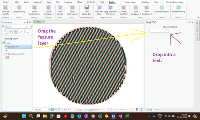

How to drag a feature layer from table of contents and drop to textbox in ArcGIS Pro SDK in custom dock pane?
796
05-21-2024 01:53 PM
AbhijeetNandeshwar1
I am using the following example as a reference.
https://github.com/Esri/arcgis-pro-sdk-community-samples/tree/master/Framework/DragAndDrop
Any inputs will be appreciated.
Thank you,
Abhijeet
