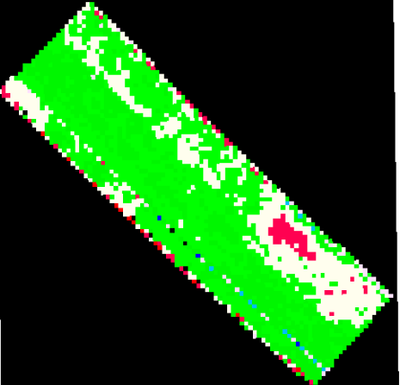

Hi Team,
I'm having an issue on having black background on tiff image created by ia.Merge using arcpy.
I want the black part to be transparent just like output data when I use sa.Reclassify(raster, "Value", remap, "NODATA")

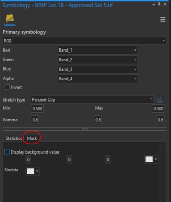

Katie_Clark
MVP Alum
I had to deal with something similar the other day. What worked for me was going into the symbology pane for the raster layer and changing the value under the "mask" menu:
