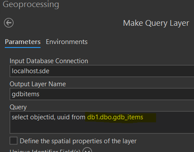

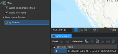

KirkKuykendall1
I'm able to create a standalone table using the Make Query Layer tool.
After doing that you should have a standalone table like this:
You should be able to read it as you would any standalone table.
If you don't want a standalone table, you could use OpenQueryTable
