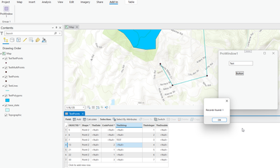

You should be able to set a breakpoint inside the action for the QueuedTask.Run and step through the code.  I suggest that you also add a try {} catch {} to get any exceptions that are thrown by your code (i.e. misspelled field names).
This is what I saw with my sample code running:

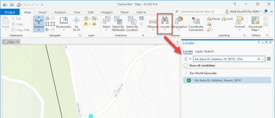

I would recommend using a Dockpane instead of a ProWindow that works similar to the 'Locate' Dockpane in ArcGIS Pro:
On the top of your search Dockpane i would show a drop down that allows the user to select the type of search they want to perform.  Once the user selects the search method the fields specific to the search are displayed.  After the search completes the found records are displayed in a list below the search query info just like on the ArcGIS Pro locate dockpane.   There are plenty of community samples that do something similar.

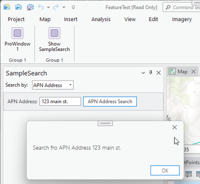

I attached a search sample dockpane that looks like this:
However you implement this, i would avoid handing off the UI between different windows or dockpanes.  If you have to implement any type of map manipulation (depending on the user's search option selection) do it within a QueuedTask.Run and await the action.

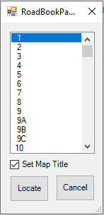

RichardFairhurst
MVP Alum

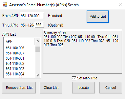

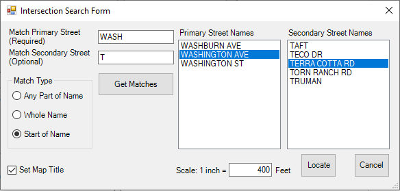

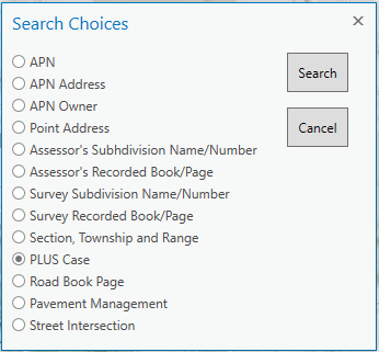

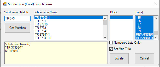

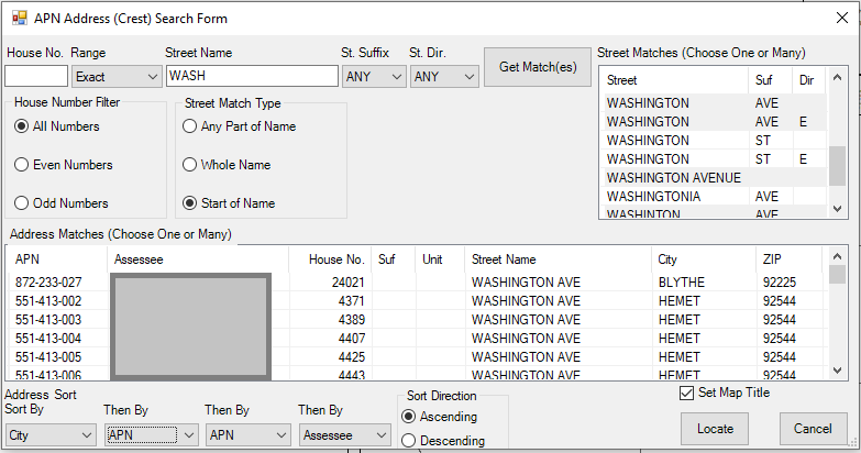

The Search Forms layouts would have to undergo a huge redesign to fit in a single dockpane.  A Button and combobox in the Quick Access Toolbar is working out great.  The button launches the chosen search option as a modal ProWindow which has control over the application until the user either cancels the search dialog to close it or choses a valid feature or list of features and presses the Locate button, which closes the dialog and displays the features on the map.  The forms do not cover valuable screen area when they are not explicitly requested by the user.  My users are very familiar with how my forms behave in ArcMap and want the same experience in ArcGIS Pro.
I also do not see a benefit of keeping the form available in a dockpane and having to monitor everything the user might do in the project that would force the search in progress to reset itself.  The user is unlikely to know what would trigger a reset and do it without realizing why the search interface reset itself. In fact I don't know all of the possible things a user could do that should trigger a reset and don't want to try to imagine what they are or have to debug them all.
While some of the forms are tall and narrow and would easily work in a dockable window, other forms have to be quite wide to be useful.  I do not think redesigning those dialogs to fit in a single dockable window is really an option.  I also don't want to have to control the width of the dockable window or worry that the user might resize it in a way that would make the form unusable.

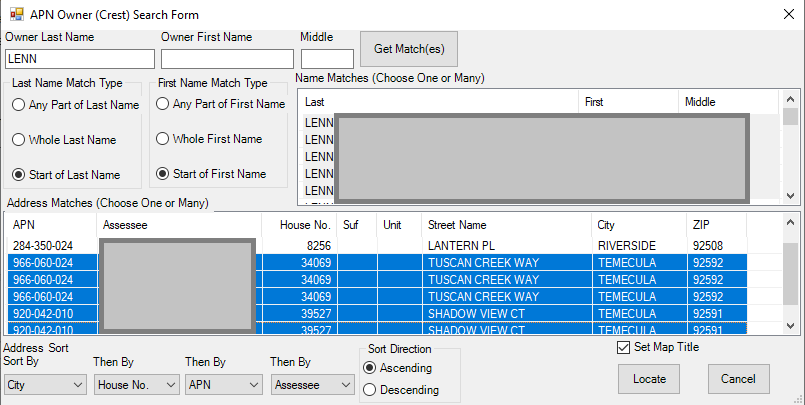

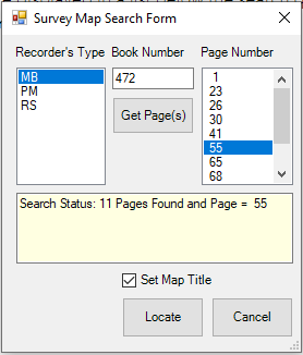

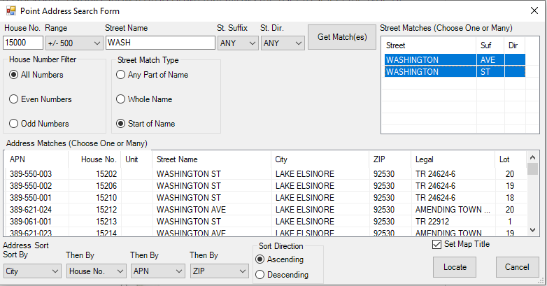

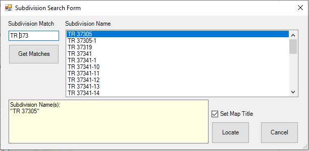

Anyway, here are the form designs I am trying to port which may give you a better idea of why I think using separate ProWindows is the best design.  So far, all indications are that I can make that design work now that only one ProWindow is open at a time and I am no longer calling a ProWindow from within another ProWindow.
