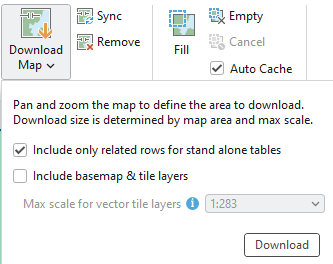

RussellBrennan
I am pleased to share that we have implemented this enhancement for the next release of ArcGIS Pro.
Note: This uses an origin > destination approach where the origin table must be the feature data and the destination table must be the stand-alone table. If the stand-alone table is the origin table the stand-alone table will be empty when taken offline using this new option.
We will be providing a check box on the Download Map button to allow you to take only the stand-alone records that are related to features in the map. This is what it will look like.
