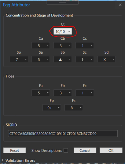

I have an ArcGIS Pro AddIn I’m developing and I’m having an issue with ArcGIS Pro Theme Styles being overwritten (I think). I need to change a property in a ComboBox based on an event trigger. This needs to be done in the WPF control’s “Style” section. However, when I do this it seems to overwrite the ArcGIS Pro Theme Style (see below). Is this expected behavior and is there a way I can avoid this?
<ComboBox Width="60" MaxDropDownHeight="540" HorizontalContentAlignment="Center" ItemsSource="{Binding Concentrations}" SelectedValuePath="ManiceCode" SelectedValue="{Binding CT, Mode=TwoWay, UpdateSourceTrigger=PropertyChanged}">
               <ComboBox.Style>
                              <Style TargetType="{x:Type ComboBox}">
                                             <Setter Property="DisplayMemberPath" Value="Description" />
                              </Style>
               </ComboBox.Style>
</ComboBox>

VidmasKondratas
I already tried this. It doesn't work for me. Have you tested this with the "Dark Theme" while adding a style section to the combobox? All the comboboxes in Pro use the "Dark Theme" when in "Dark Theme" by default (like the dark ones in the attached picture). Open any out-of-the-box tool in Pro while in "Dark Theme" and look what the comboboxes look like. Doing the dynamic resource brushes from the Esri style guide still just switches everything to "Light Theme" for me after adding the <ComboBox.Style> section. The items in the comboboxes still are using the "Dark Theme" however which makes them unreadable. I'm suspecting because I haven't added a "Style" section to the items. The "Style" section contains a "BasedOn" property to allow inheritance, but you can't use it with dynamic resources and I don't know how to set this. It appears that adding a "Style" section will override any Esri styles.

VidmasKondratas
Yes, that works. Thanks! I was missing how to set the "BasedOn" property correctly:
BasedOn="{StaticResource {x:Type ComboBox}}"
So adding this ComboBoxStyle with the "BasedOn" property above as a static resource and setting all the ComboBox styles to it is giving me the exact behavior and look that I was expecting:
