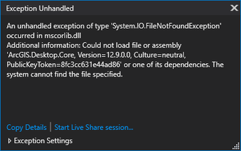

Hello,
I am using the Esri.ArcGISPro.Extensions NuGet package to build my ArcGIS Pro add-in without a physical ArcGIS Pro install (https://github.com/esri/arcgis-pro-sdk/wiki/ProGuide-ArcGIS-Pro-Extensions-NuGet). This does seem to work great for compiling my add-in.
However, I also have existing unit tests (https://github.com/esri/arcgis-pro-sdk/wiki/ProGuide-Regression-Testing) that are now failing because they still try to reference the ArcGIS Pro install:
This is what the MSTest section in my .runsettings file looks like:
<MSTest>
        <TestTimeout>90000</TestTimeout>
        <MapInconclusiveToFailed>false</MapInconclusiveToFailed>
        <CaptureTraceOutput>true</CaptureTraceOutput>
        <DeleteDeploymentDirectoryAfterTestRunIsComplete>true</DeleteDeploymentDirectoryAfterTestRunIsComplete>
        <DeploymentEnabled>false</DeploymentEnabled>
        <AssemblyResolution>
            <Directory path="C:\Program Files\ArcGIS\Pro\bin\" includeSubDirectories="true"/>
        </AssemblyResolution>
    </MSTest>
Is it possible to point the AssemblyResolution to the Esri.ArcGISPro.Extensions NuGet package, or do the ArcGIS Pro unit tests require ArcGIS Pro to be installed on the same machine?
Thanks,
Greg
SrinivasVinnakota
Executing ArcGIS Pro tests requires ArcGIS Pro to be installed and licensed on the same machine as the tests are run.
