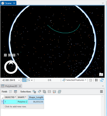

GKmieliauskas
Hi,
Take a look at the other thread@AnnetteLocke sample for works for me.
GKmieliauskas
Hi,
EdwardBlair
Works great!   Thank you.
