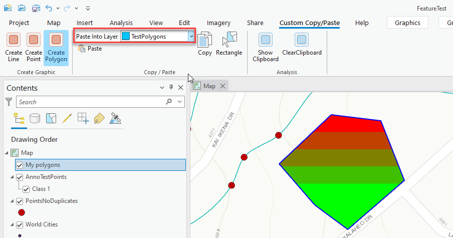

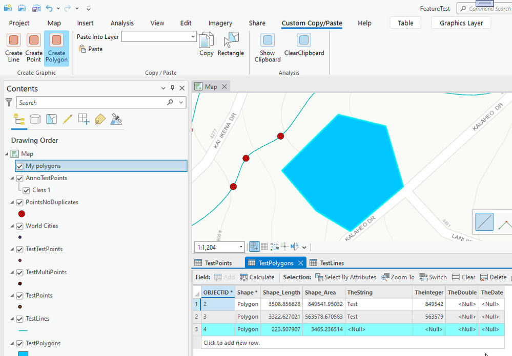

Sorry for the delay.  I attached a copy/paste sample project to this reply.  As @GKmieliauskas  mentioned there is no published ArcGIS Pro standard on copy/paste published (instead all copy/paste handling is custom), so you have to implement your own copy/paste handlers in your Module class.  The attached sample implements the paste part since i encountered some issues with intercepting the copy (and cancopy) actions, which we will try to address this in an upcoming release of ArcGIS Pro.  However, i think you can still use the attached sample to get your desired workflow done.   The same has a readme.md included which describes the usage.  But in summary the sample allows the operator to create a geometry, then select the destination layer (which could be determined through a TOC selection or other means) and then use the ArcGIS Pro built-in Paste button to paste the geometry into the destination layer.

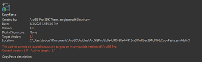

I've also hit a snag with inspecting the addin-sample you sent over. I get an error-message in the "Add-in Manager" that the addin targets version 3.1 of ArcGis Pro when I run it in debug-mode. Is there some settings I have overlooked?
UPDATE: I found out how to fix this last issue, so no worries. Again, thanks a bunch for the sample and reply.
