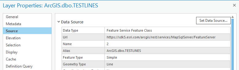

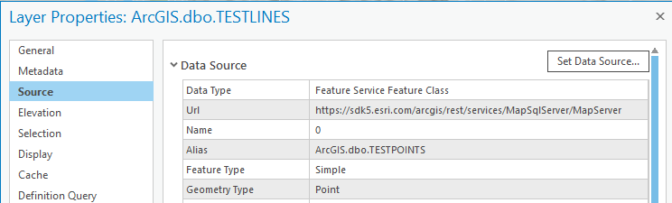

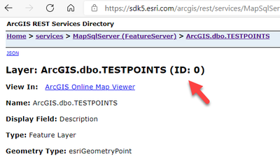

To change the URL to the hosted feature service you have to change the Url, to change the ID you have to change the Dataset property as shown in the sample below.  When you say you have to change the 'ItemID' to the hosted feature service do you mean the ID?  As shown here:
If so then, my sample applies to your question. in the sample I change this (note that the ID is shown under the Name line item):
To this:
In this sample snippet the datasource for the layer is changed from FeatureSerive to MapService and vice versa, and in addition the ID is also changed from '0' to '2' and vice versa.

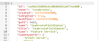

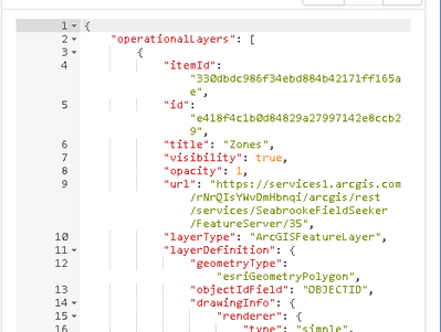

I am not trying to change the ID of the layer. I am trying to change the itemId -- which is the reference to the hosted feature service. I've changed the data source as you've indicated above, but that does not change the itemId. Using ArcGIS Online Assistant, I can see the ItemID is "330dbdc986f34ebd884b42171ff165ae". This is not the ID for the feature service 'SeabrookeFieldSeeker' as you can see from the second image.  This is causing the map layers to reference a hosted feature service that is not the one in the URL.
Wolf
by Esri Regular Contributor
My bad, I guess I overlooked the 'ArcGIS Online' part.  The actual 'Feature Service' is hosted on ArcGIS Server referenced the the "url" attribute of the "operationallayer" json from your previous reply.  I only looked at the ArcGIS Server datassource, not a Portal (ArcGIS Online) connection.  I will try a Portal datasource now and let you know what i find.
