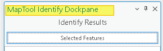

Hi,
I would like to change the xaml <UserControl> TITLE
I am based my script on this sample :
https://github.com/Esri/arcgis-pro-sdk-community-samples/tree/master/Map-Exploration/MapToolIdentify...
😁Thanks a lot for your help
KenBuja
MVP Esteemed Contributor
That's modified in the Config.daml file in the dockPane caption property
        <dockPane id="MapToolIdentifyWithDockpane_Dockpane" caption="MapTool Identify Dockpane" className="MapToolIdentifyDockpaneViewModel" dock="group" dockWith="esri_core_contentsDockPane">
          <content className="MapToolIdentifyDockpaneView" />
        </dockPane>
KenBuja
        </dockPane>
GregoireCatineau
It's work perfect ! thank you very much !
