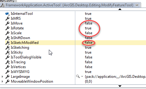

Is there a way to see this data in code for the FrameworkApplication.ActiveTool?  I think if I can cast the ActiveTool to ModifyFeatureTool, I could get what I want from the IsSketchModified field.  But I can't find a way to get this.  I have been debugging, and I am finding that the IsSketchModified is true for any shape changes, and false for attribute only.  This would do it for me, but can't find a way to get from ActiveTool to ModifyFeatureTool.

You could use reflection but now you're getting into unsupported territory.

that is the type of thing I want.  But i also want Move/Rotate/Scale values.  I cant seem to get the binding flags right, it keeps turning up null?

Its the internal inheritance. "IsMove" isn't on the basetype but you can still get it from the instantiated type.
      var ismprop = activeTool.GetType().GetProperty("IsSketchModified", BindingFlags.FlattenHierarchy | BindingFlags.NonPublic | BindingFlags.Instance);
      var improp = activeTool.GetType().GetProperty("IsMove");
MKa
In order to get that the shape changed from either vertices/delete/reshape you can use the arg on Module to get the difference in the shape.  In order to do this in the OnRowChange Event you need to get both the OriginalGeometry and the NewGeometry first.  You can compare them using .equals to get that change.  In order to detect a move/rotate/scale, you will need to use the above methods to find out if IsSketchModified, IsMove, IsRotate, or IsScale is true.  If these conditions are false, then you can assume that the change came from the OOB Attribute Editor.
