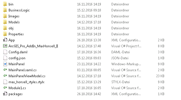

First I have to say, I want to ship my style-file (*.stylx) with my addin project. So I created a *.stylx file and saved it under my addin project root folder.
I`m also shipping the config.json with my project and for that I added both existing items into my VS project and set "always copy" for both files.
