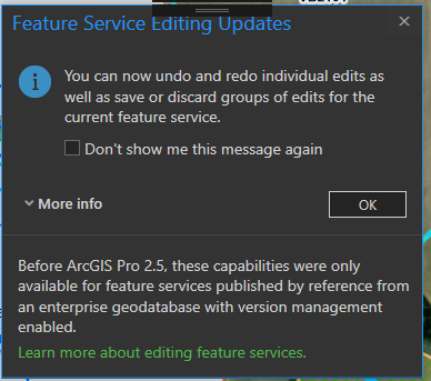

2.5 Issue with Feature Service Editing Updates window
2635
6
02-07-2020 08:49 AM
MKa
protected async override void OnClick()
            try
                await QueuedTask.Run(async () =>
                    Inspector selectedItemInspr = new Inspector();
                    selectedItemInspr = await FeatureServiceManagement.GetFirstSelectedItem();
                    if (!selectedItemInspr.IsNullOrEmpty() && !selectedItemInspr.Shape.IsNullOrEmpty())
                        FeatureLayer FieldFeatureLayer = FeatureServiceManagement.GetFeatureLayer("Field");
                        if (FieldFeatureLayer != null)
                            EditOperation CreateCurrentOperation = new EditOperation
                                Name = "Create Field Button"
                            //Create a feature with a polygon
                            CreateCurrentOperation.Create(FieldFeatureLayer, selectedItemInspr.Shape);
//THIS IS HUNG
                            CreateCurrentOperation.Execute();
            catch (Exception e)
                LogError("CreateField - OnClick", e);
I just installed 2.5 and have begun to test my addin and have run into a problem right away.  I have a button that creates a feature based on a selected feature using an Edit operation.  After the Execute() command is run, it looks like the warning box for editing updates might be blocking the UI.  It just sits and spins waiting for the Execute command to finish.
by Anonymous User
Not applicable
This was discovered too late in the 2.5 release to get in. The fix to not show the dialog for api calls is in for 2.6 and is a patch candidate for 2.5.
The setting is stored in the application settings file (user.config) at \Users\user\AppData\Local\ComapnyName\Hashed_AppName\version.
The workaround is to let user manually click 'dont show again' when the dialog appears.

MKa
This is also happening on a DataInspector.Apply().  The Screen comes up and i hit ok, but my code is stuck on the Apply line of the code
MKa
I need a quick workaround to this or to somehow set the registry setting on the users install?  Is there a registry setting for this that is configurable on install, much like the "Check for Updates" option.  Ideally I would like to make a code change and prevent the popup in general.

MKa
This worked great.  I will remove the code for 2.6, but I put this in the initialize of my module to only change the value if the user has the initial value or somehow set it to show.
bool DontShowEditWarning = GetDontShowFSEditNotificationSetting();
if (!DontShowEditWarning)
SetDontShowFSEditNotificationSetting(!DontShowEditWarning);
MKa
This code fails when the user loads their Map for the first time as the section
ArcGIS.Desktop.Editing.Settings
Is not present in the user.config.  When i try to create the section it says the config is locked.  I need to be able to get to that flag at startup regardless of whether the section is currently there?  How can I make the section at startup?
This doesn't work right now when I do config.save.  Again this is on the first time map load, remove user.config and the code should break at config.save
I had to account for the editingsection missing and then create it.  I can't seem to accomplish this

MKa
I had to add the section like this below in order to get the config to save.  It now works and I can create the section.
