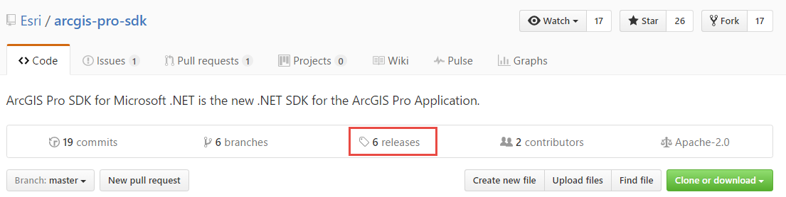

Regarding the API references, you can always find the API reference of any of the SDK releases, along with the SDK installation files, at the Releases page.  You can access it from the Pro SDK Github page and then press the "releases" link, as seen outlined below.  You can also navigate there directly here, and bookmark it.
