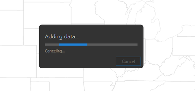

Not only it is still the same in 3.3, but now cancel adding data from Agol or Living Atlas (which takes forever by itself) is behaving the same
10+ minutes and still didn't cancel....
