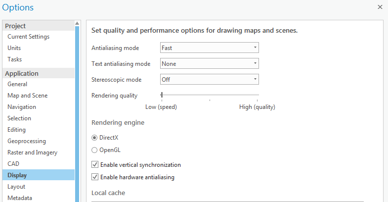

Nothing to do with all the network issues, but I've had a pretty good performance boost by turning off all the antialiasing options, and setting rendering quality Low in the Options--Display menu. Might be worth a shot for everyone following this thread.
AndrewQuee
Thanks for that.  I thought those options would depend only on the GPU - I was running 40% load most of the time so I didn't try them.  I was consistently CPU bound, pegging it to 99%+ for the whole time.
Worth a shot to test though.  If Pro is using the CPU to render graphics and ignoring your video card's capabilities, well that explains a lot, in particular why this thread exists.
