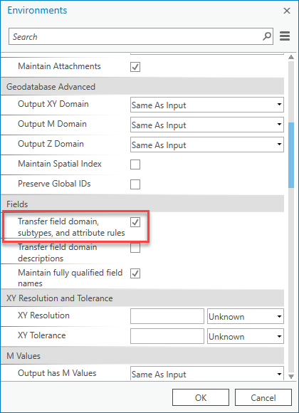

I then tried to do this in ArcGIS Pro and don't know where this setting is. I don't see it in the Environment tab. Is it missing or is it somewhere else?
Jared_Motuz
Hi Cathy,
These settings can be found within the Environments window on the Analysis ribbon tab.
Geoprocessing environment settings
Geoprocessing environment settings—ArcGIS Pro | ArcGIS Desktop

NajmehServatsamarein2
When I export a feature class from the geodatabase to a shapefile, I don't see the domain descriptions in the attribute table—only the numbers appear. I’ve checked the box for "Environments" and selected "Transfer Field Domain Descriptions" during export, but the issue persists.
Kevin_MacLeod
This is a bug which has been present on the platform for 15 years.  You can check the Env setting. It does nothing.  After significant and extensive repro testing on my end, Support assigned a Bug ID to me for this.  It's a bug in most ArcMap versions and all ArcGIS Pro versions, when exporting from SDE and even from file GDB.  From the GUI and from Python.   Only some fields are blank not all fields. Odd since they are the same data type even. Only Table to Excel gets around this bug. We have a complicated model to export to SHP by joining the Excel table to the Shapefile.   BUG-000179097
