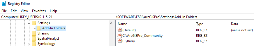

BarryNorthey
I added a couple of Add-In folders through Pro and then searched the Registry for their paths as text. Pro created an Add-In Folders folder as shown in the screen capture. I was also able to create a new Value (folder path) that appeared in Pro. Perhaps this is what you are looking for.

Bingo. Thanks.
The vast majority of Pro's other settings are exposed in various files hidden around, so I didn't think to check the registry.
