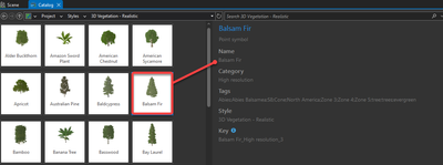

GBacon
Andrew, that is the text that I've relied on for past versions of Pro and gives rise to my question since genus no longer seems to work. Is genus not working because it is not included in the name field shown below? Is this what my field is being matched against? If so, it makes sense that only common name in my attached shapefile would work. I checked an older version of Pro (2.9) and the properties look exactly the same for this tree, yet it can match using genus field or combined genus/species field. Version 3.0 only works using the common name field.
I also noticed the Match Layer Symbology to Style doesn't open the dialog to do this, so I end up running the GP tool from the toolbox.
Would you be willing to test this using the attached shapefile?

Andrew--Johnson
Hi,
I reached out to another team to get clarification on this and they confirmed that the core styles use the common name and not the genus. The match layer symbology to a style will always use the symbol name so in this case it will only work with common name. If you only had data with genus you could create a new style where the symbol name of the realistic tree matches the genus and then in that case it would work to use the match layer symbology to a style but it sounds like it will still work for you to use common name moving forward.
