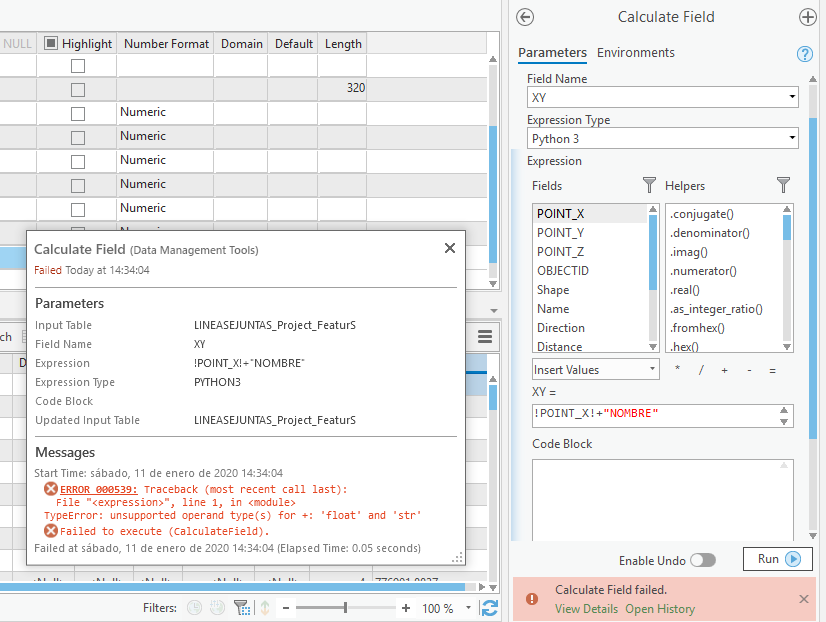

WHAT I HAVE PROBLEM WITH THIS EXPRESSION
2263
6
01-11-2020 11:38 AM
ArmandoFreites
I NEED PUT THE COORDINATE AND THE WORD : NOMBRE, LIKE: 57485.258 NOMBRE
JoeBorgione
MVP Emeritus
POINT_X and POINT_Y are both numeric type fields.  You will need to add two new fields of String type in order to concatenate the word NOMBRE to it.
Add two new string type field, naming them as you wish.
Then in the field calculator you can copy and paste the following for each of the new fields:
str(!POINT_X!)+' '+'NOMBRE'
str(!POINT_Y!)+' '+'NOMBRE'
This casts the value of each variable to a string and then puts a space between the value and NOMBRE.  You may need to set the format of the POINT_X and POINT_Y fields to the number of decimal places you want to display.
That should just about do it....

To avoid whether you need cast things to strings, learn the python "format" mini-language.  It can all be done on 1 line and is even more powerful than its sibling the f-string.
 "{} {}".format('a string', 1)  # ---- implicit order
'a string 1'
"{1} {0}".format('a string', 1) # ---- explicit order
'1 a string'
"{}{}{}".format('stuff', " in between "*3, ['a, b', 1, 2.0])  # ---- it can do anything
"stuff in between  in between  in between ['a, b', 1, 2.0]"
