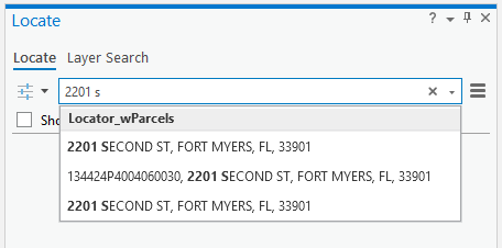

Josh_Ittenbach
Shana,
I am attempting to build a locator with point addresses linked to parcels with site addresses similar to option 3 you described here.
The problem I'm running into is de-duplicating the results. All combinations I've tried produce suggestions with both point and parcel addresses:
The only time it reliably suggests a single point address is when there are multiple point addresses linked to a single parcel.
Is this expected behavior? I've tested with Pro 2.7.1 and Enterprise 10.8.1.
